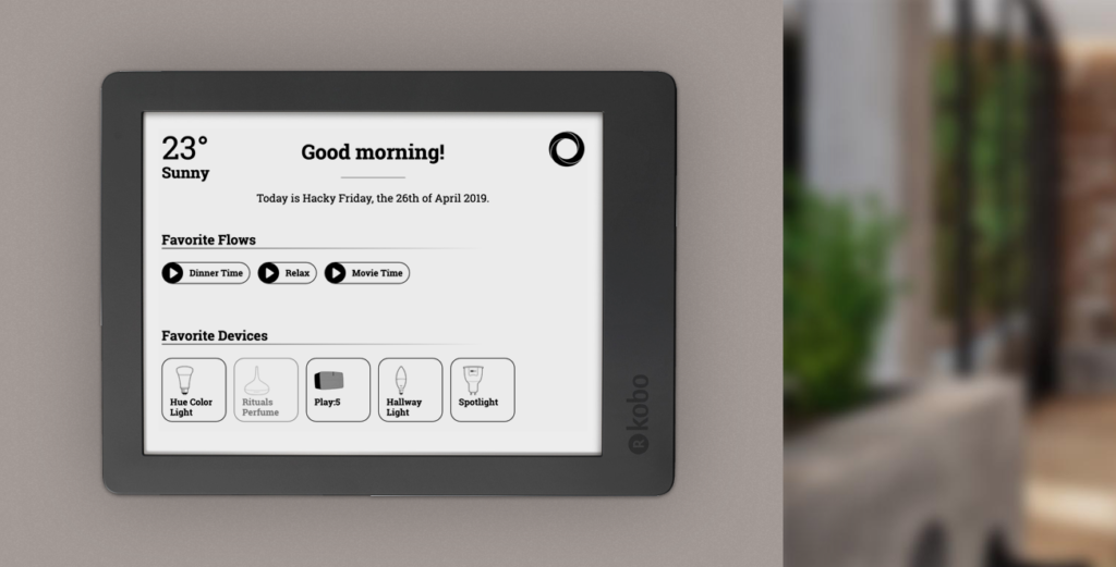

You probably already saw this coming, but my project today was creating a dashboard, tailor-made for e-ink readers. I picked the Kobo Aura H2O Editon 2 because it was affordable, hackable and has a high-resolution 6.8" screen. For € 179,- you can buy one in various shops.
Creating the dashboard was fairly straightforward by coding some HTML, CSS, and Javascript with the Athom Web API. The e-reader then displays this dashboard webpage in its web browser.

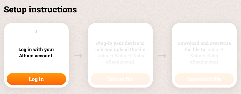

Luckily, both problems could be solved by creating a landing page, available at https://homey.ink. Users can log-in with their Athom account, upload their Kobo config file found when plugging the reader into the USB port of your computer. The webpage then changes this file by setting the homepage URL to https://app.homey.ink with the token in the URL. Lastly, a hidden flag for fullscreen browsing is added, and the updated config file can be replaced on the e-reader.

My hacky friday is over, and my e-reader has found it's place on the wall. It survives about two days on a full charge, so it still needs to be connected to a power source. But knowing its energy usage, however, I feel very comfortable with that.
You can view the end result at https://homey.ink. The code is open source and available on GitHub. I've also added some code to support more devices based on themes. Other e-readers, or even powered tablets, could also benefit from this project. I'm looking forward to contributions from other developers. When you've set up your own wall-mounted e-reader, definitely share a picture in the Homey Community!
