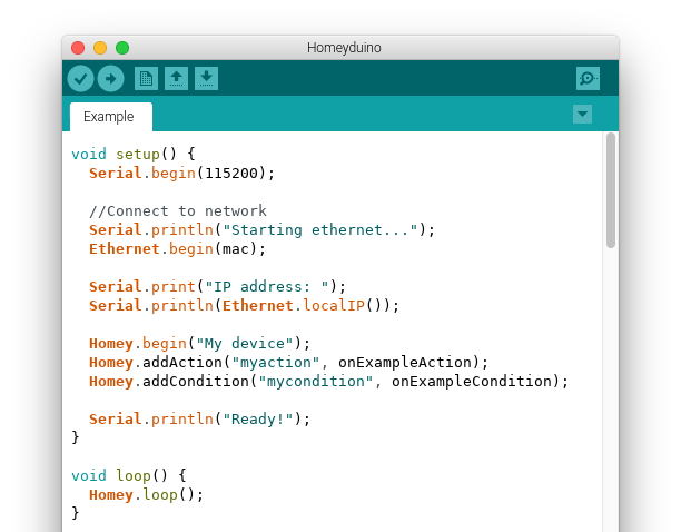

The idea is that you define the functions your device has in your Arduino sketch. On the Homey side you won't have to write a single line of code.
After establishing a network connection, your Homey connected creations adventure begins. Simply call "Homey.begin("My device");". Creating actions, conditions and triggers is as simple as defining them, using the "addAction", "addCondition" and "trigger" functions.

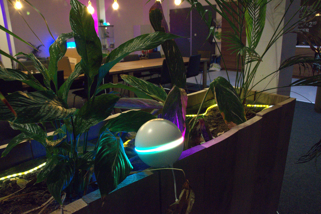

In our office we have a planter. It doesn’t look as nice as it could be. Mainly due to the fact that the plants in the planter have been neglected for a while now. Unacceptable of course. Our solution for the problem was simple: we automated the planter using Homeyduino!

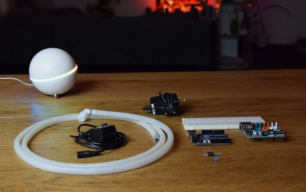

The project is based around an Arduino Uno combined with an Arduino Ethernet Shield. You'll need the following to put it all together:
  • Homey
  • Arduino Uno
  • Arduino Ethernet Shield
  • A breadboard
  • 12v DC wall-plug adapter
  • Small 12v water pump
  • Piece of tubing
  • N-type mosfet
  • 1KOhm resistor to use with the pump
  • Water
A detailed instruction manual can be found here.

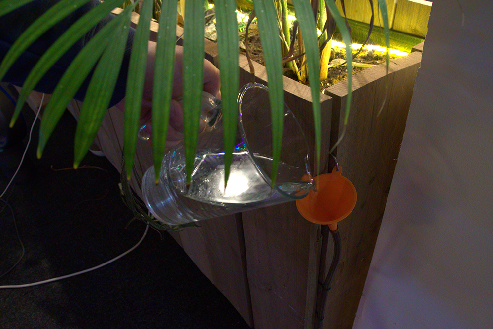

Fill the tank once in a while and Homey will water our plants for us. Now, you might wonder, what happens if water runs out? We even thought about that! Once the tank is empty, Homey warns us by saying "Tank empty!" and fading the ledstrip we built into the planter.

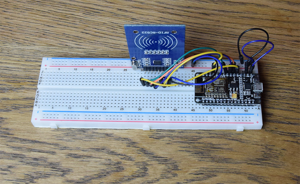

Homey can read RFID cards such as your public transport card. This feature has a lot of potential applications. However, for many of these applications you have to physically touch your RFID card to your Homey. This can make implementing your RFID ideas a bit of a hassle.
Using Homeyduino you can easily make your own cardreaders that work with Homey. You don't even have to be physically near Homey. This way, you can place the reader wherever you want.
