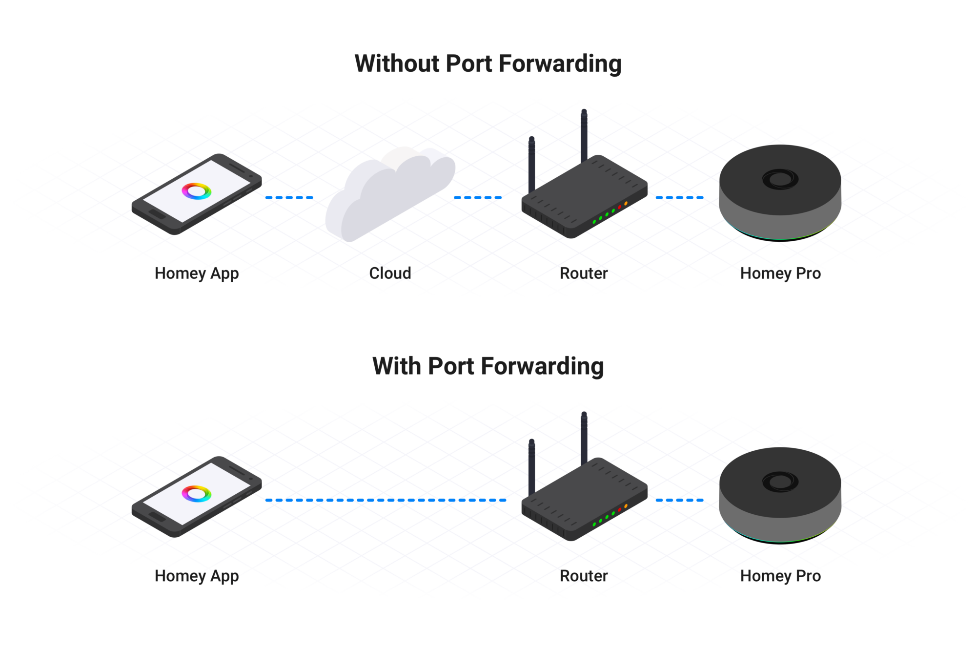

When you open the Homey iOS, Android, or Web app, an advanced algorithm tries to find the fastest & most secure route to your Homey Pro.
For example, when you're at home and on your Wi-Fi, the app prefers a local & secure connection. But when you're outside of home, we relay the encrypted traffic between the app and Homey Pro through our cloud servers.
Port Forwarding is another method for when you're away from home. It bypasses our cloud services entirely and goes straight to Homey Pro. This means it's faster and more reliable. It just requires a one-time setup on your Wi-Fi router, enabling direct traffic to your Homey Pro from outside your home network.

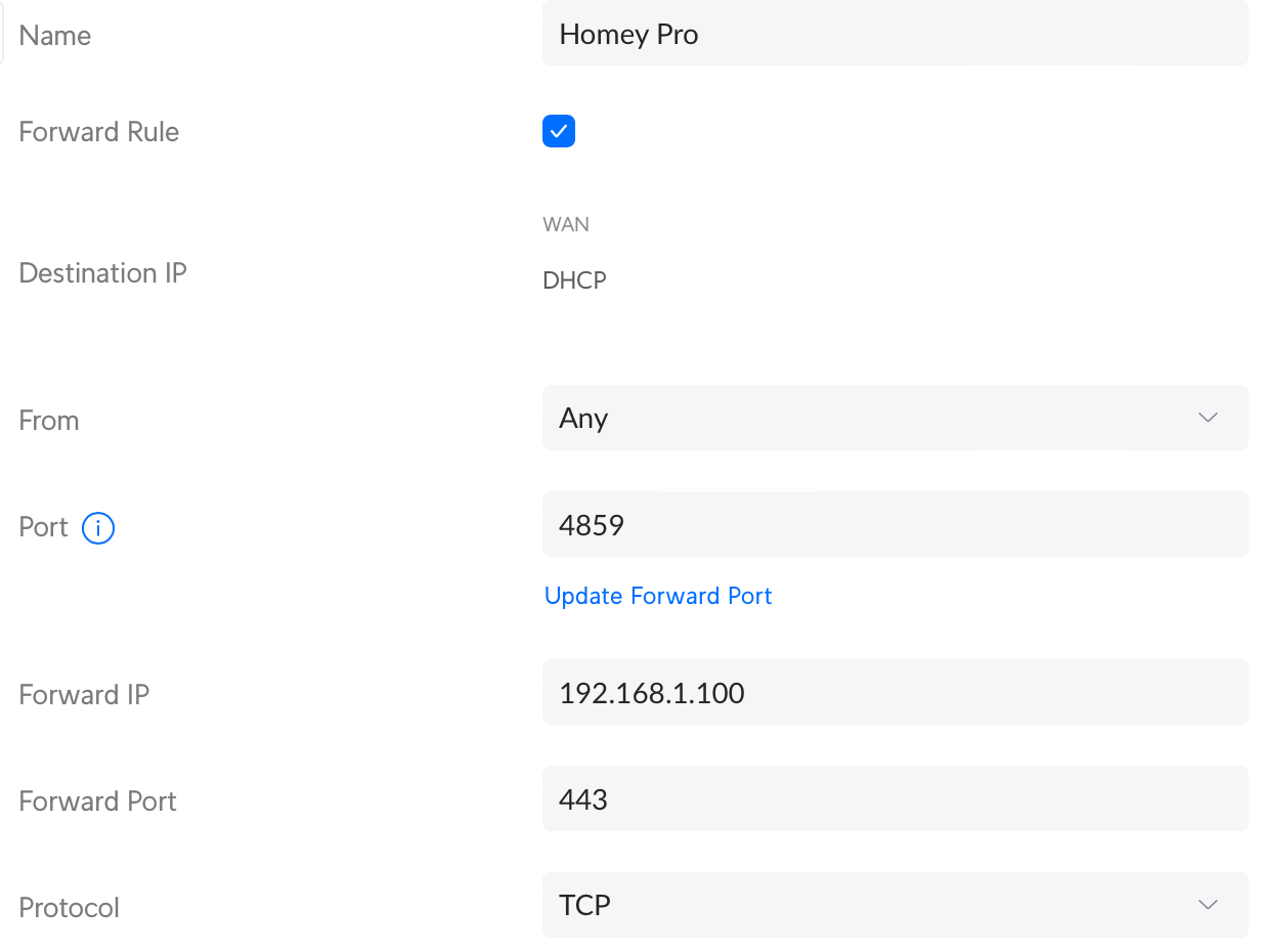

Step 2 — Forward a port to Homey Pro
While still in your router, choose an external port to forward to Homey Pro. We suggest port 4859.
Forward the external port as TCP to Homey Pro's IP address, and Homey Pro's internal port 443.
An example of a Port Forwarding rule in a UniFi router.

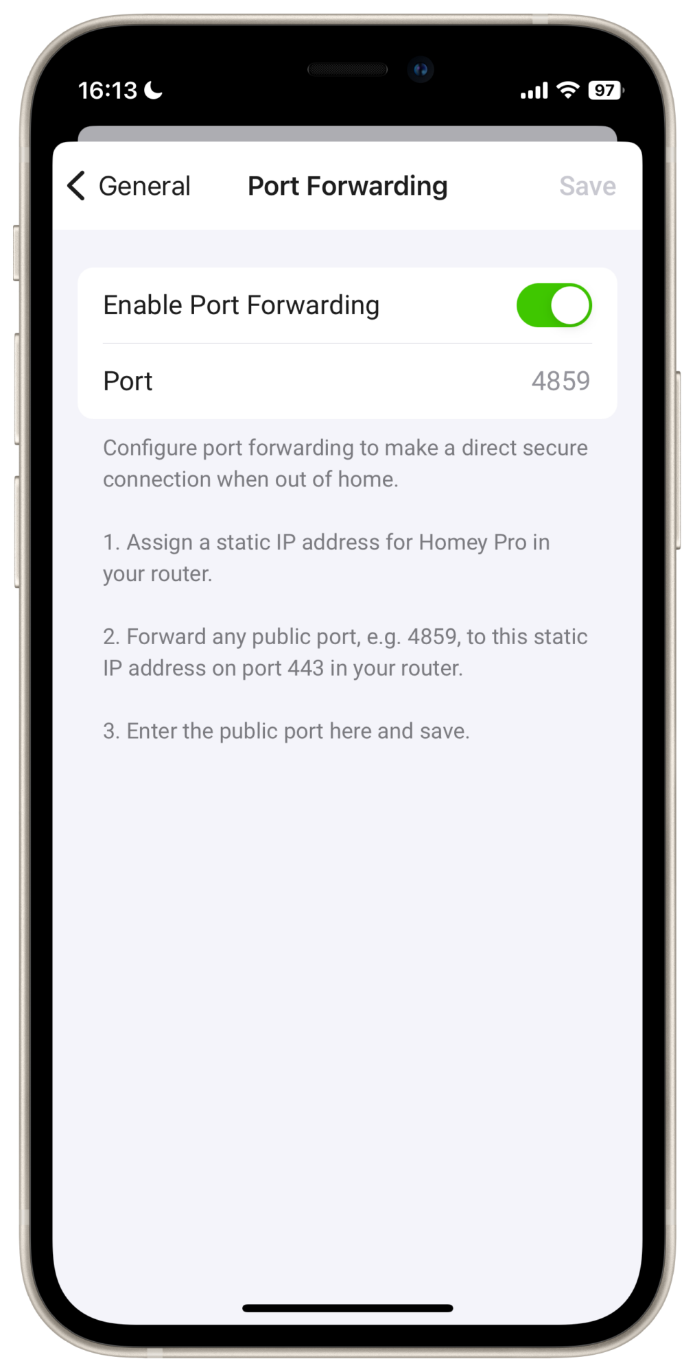

Step 3 — Enable Port Forwarding in the Homey app for iOS/Android
Within the Homey app, navigate to More → Settings → General → Port Forwarding. Toggle on Enable Port Forwarding, and enter the external port you've chosen in step 2. In our example, we picked port 4859.
Then tap Save. Homey Pro will automatically validate if the port is forwarded correctly.
