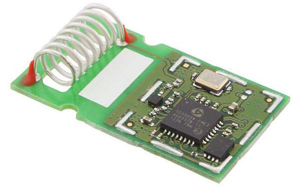

Homey embeds the ZM5304 module, the most recent and advanced Z-Wave module available. What exactly happens inside of the chip is Sigma Design's work, but we have programmed Homey to talk to the chip to do our magic.

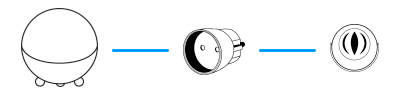

One of the advantages of Z-Wave is its so-called 'mesh network'. What this basically means is that devices in your network, e.g. Homey, a plug and a sensor, can wirelessly reach each other by using one another. Imagine you have Homey in your living room downstairs, a plug in the bedroom upstairs and a motion sensor in the attic.
When the motion sensor goes off, and wants to reach Homey, it sends a signal to the plug, and the plug forwards this message to Homey. A signal can make up to 4 hops, increasing the effective range a lot. To save your sensors batteries, only devices connected to a permanent power source repeat signals of other devices.
This mesh network is a big advantage over protocols such as Wi-Fi or Bluetooth, because the range can be increased with every device added to the network. It also keeps the devices' energy usage very low. In the future, we will update Homey's software to provide a visual map of the Z-Wave network at home.
A simple mesh network. The sensor (right) contacts Homey (left) through the plug (middle)

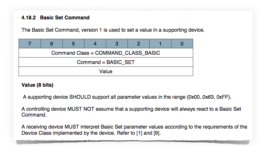

The Z-Wave documentation defines how messages look. In the simplest case, a BASIC_SET message, can send one byte (a byte is a number between 0 and 255). For example, when Homey sends BASIC_SET with byte '255' to a socket, the socket will likely turn on. Sending '0' will turn off the socket. More advanced commands can specify many parameters, which are essentially many bytes glued together. It depends on the Z-Wave controller (Homey) if a device can be supported, because it must know these commands.

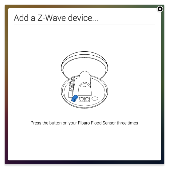

With our experience, we've chosen to take a unique approach, because we always design for the best user experience. One of Homey's unique assets is our App Store and our community who helps building them. The best user experience, we thought, was a dedicated app for every device. By this method, Apps don't only pack the right Command Classes, but also include specific icons, pairing instructions and options, making pairing, recognising and using devices way easier.

Z-Wave is a very low-level protocol, because every byte sent counts. Values are usually stored in bytes, a bitmask (e.g. 1011 could mean yes, no, yes, yes) and other types of 'harder' programming concepts. The BASIC_SET message we talked about earlier sends 255 as a 'yes', for example.
This creates a problem, however. Homey developers are used to JavaScript, because all Homey Apps are written in JavaScript. Ideally, the developer could send 'BASIC_SET' with a value 'true', instead of '255'. For example:
node.CommandClass.COMMAND_CLASS_BASIC.BASIC_SET({
    "Value": true
}, function( err ) {
    if( err ) return console.error( err );
So that's exactly what we did! Sigma Designs provides a .xml file with all the Command Class definitions, which is used for their debugging software. At Athom however, we're the good kind of lazy, so we wrote a script that takes this file as input, and generates a .json file for every Command Class with all its Commands and parameters.
Homey then loads these .json definitions, and automatically generates the Command Classes and their Commands for each Z-Wave device. All possible types of data, e.g. Byte, Bitmask, etc. can be converted from a JavaScript object to a raw Buffer (to send), and vice versa when Homey receives a 'REPORT'. A few weeks ago, Sigma Designs released a new version of their specification. It took us literally 2 minutes to update Homey to this new version, because of our unique approach!

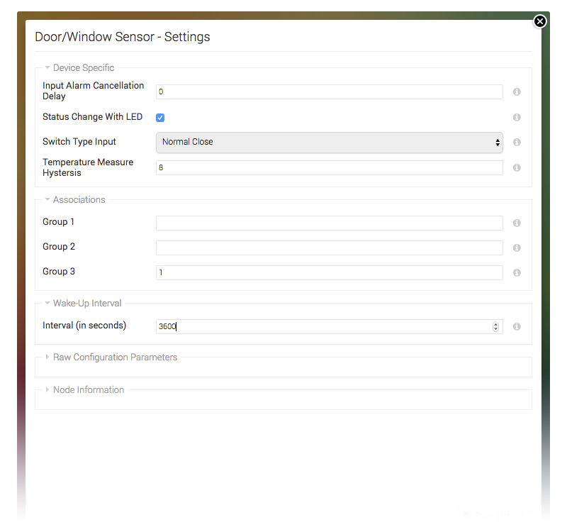

Some generic features can be better managed from Homey itself, than to reinvent the wheel for every app. For example, most battery-powered devices have a 'Wake Up Interval', which is the amount of seconds it'll take for them to be reachable to receive commands, e.g. new settings or a GET command.
Upon pairing, Homey reads this value, and optionally set a new value if the app developer provided a new value. The same happens for associations, which are the 'channels' Z-Wave devices can send messages on when something happens. For example, if an app needs a 'BATTERY_REPORT' command, but the device only sends that report on Association Group 3, the app developer can instruct Homey to make Homey join group 3 upon pairing. Default configuration parameters behave the same. As you can see below, app-specific settings and Homey-core settings work very nice together.

Upon pairing, a so called 'interview' takes place. This is simply Homey asking the device for information useful afterwards. For example what the device's Manufacturer ID and Product ID are, the supported Command Classes and their versions, etc. When that's done, Homey looks if there's a compatible app installed, and then figures out if any app-specific commands have to be sent.
As discussed above, these can be default configuration parameters, association groups, etc. It is not possible to search our App Store during pairing, because some battery devices go to 'sleep' if Homey has to find, download and install an App in the meantime.
So make sure, when adding a Z-Wave device to Homey, to download the App first. A device that's asleep makes them unavailable. We have some very neat ideas to work around this in a future software version.
