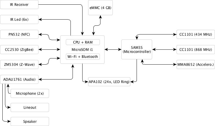

In order to produce a high quality product we believe it is essential that both the hardware and software are tailor-made to best serve its intended purpose. Think for example about gaming consoles, which can produce stunning graphics with a graphics card that is already years old. When we started with Homey there was of course no hardware we could get off the shelf, so we had to design our own. Considering our high quality requirements, eight (!) wireless protocols and an unusual design, it was definitely a challenge to fit all of that in a 12 cm sphere.
- MicroSOM (CPU, RAM, Wi-Fi & BT)
- 4 GB eMMC Flash
- Power Supply
- RGB LED (24x)
- Microphones (2x)
- Audio Chip
- 433 MHz
- 868 MHz
- Z-Wave
- ZigBee
- NFC (IC & antenna connector)
- Infrared LED (6x)
- Infrared receiver
We've often heard from respected partners that it's a miracle that we were able to get all these technologies work together without any problems. Our hardware designers really did an outstanding job here!
Homey's input/output hardware components
MicroSOM
The MicroSOM is the heart of Homey, and runs our own flavor of Linux. It communicates to all Homey's different chips over various interfaces: USB, I2C, UART and GPIO. It's IMX6 processor is clocked at a maximum speed of 1.0 GHz and has 512 MB RAM available, which allows for many apps to run on Homey.
Microcontroller
The MicroSOM's smaller brother, the Microcontroller, is placed between the 433 MHz and 868 MHz antennas. The Microcontroller takes care of those two frequencies (which in turn both have their own chip, the Texas Instruments CC1101). In addition the Microcontroller can control the LED ring while Homey is booting and manages the data stream generated by the accelerometer. A way to reset Homey was necessary, but a button wouldn't look good. This is where the accelerometer comes in handy. With the accelerometer Homey determines if it's turned upside down and can go into DFU (Device Firmware Upgrade) mode during the first 5 seconds of booting, or start Wi-Fi Recovery afterwards.
Audio
There are 2 state-of-the-art microphones placed inside Homey that record a high-quality stereo signal. The audio chip runs it's own DSP (Digital Signal Processing) software, which does noise reduction, volume optimisations and various filtering to ensure an optimised signal for our software processing. The audio chip can also play music over the internal speaker or to the jack-output, if connected. Homey also detects whether or not an audio jack has been plugged in. It can also keep track of volume states and sound muting. So, perhaps in the future if music should be playing but Homey's microphones are not hearing it, Homey can automatically attempt to turn on or unmute your speakers.

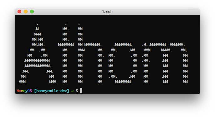

Ambitious hardware simply deserves brilliant software. We have designed our own flavor of Linux based on Debian. There are multiple hand-crafted kernel modules such as the LED Ring driver and the Infrared driver. There is a system partition on Homey, where the system files reside. Most of the space, however, is reserved for user data on a separate partition. When you reset a Homey, this partition can be wiped and Homey starts like it's brand new.
SSH (terminal) access is not available on sold Homeys for legal & security reasons. We míght release a Linux image without our proprietary software in the future.

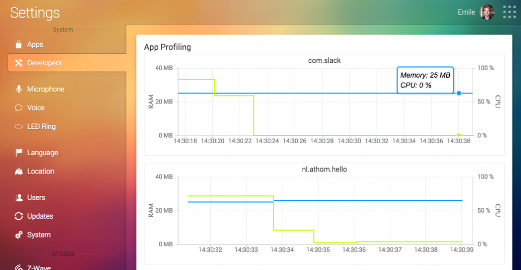

While Homey Core runs its own process, apps run in their own. An App is sandboxed, which means that it can't access the system it runs in, only specifically what an app has requested permission for. If we hadn't designed apps like this, every app would for example be able to control all your devices! An App talks through our own 'abstraction layer' to Homey Core. So every API call on the Developers API page is transmitted securely and reviewed by Homey Core before it executes. Apps can even talk to each other if they request permission before they are installed!
Apps can be profiled for performance to make sure they don't take Homey down with them
