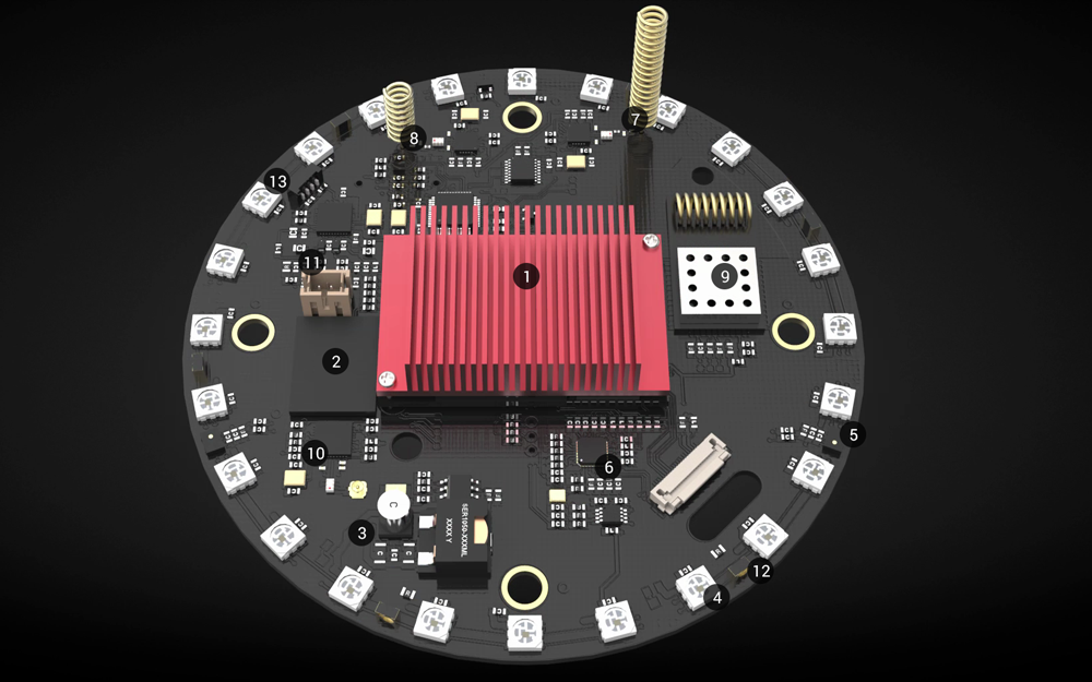

Hardware
In order to produce a high quality product we believe it is essential that both the hardware and software are tailor-made to best serve its intended purpose. Think for example about gaming consoles, which can produce stunning graphics with a graphics card that is already years old. When we started with Homey there was of course no hardware we could get off the shelf, so we had to design our own. Considering our high quality requirements, eight (!) wireless protocols and an unusual design, it was definitely a challenge to fit all of that in a 12 cm sphere.
- MicroSOM (CPU, RAM, Wi-Fi & BT)
 - 4 GB eMMC Flash
 - Power Supply
 - RGB LED (24x)
 - Microphones (2x)
 - Audio Chip
 - 433 MHz
 - 868 MHz
 - Z-Wave
 - ZigBee
 - NFC (IC & antenna connector)
 - Infrared LED (6x)
 - Infrared receiver
We've often heard from respected partners that it's a miracle that we were able to get all these technologies work together without any problems. Our hardware designers really did an outstanding job here!
Homey's input/output hardware components

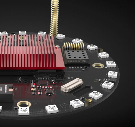

MicroSOM
The MicroSOM is the heart of Homey, and runs our own flavor of Linux. It communicates to all Homey's different chips over various interfaces: USB, I2C, UART and GPIO. It's IMX6 processor is clocked at a maximum speed of 1.0 GHz and has 512 MB RAM available, which allows for many apps to run on Homey.
Microcontroller
 The MicroSOM's smaller brother, the Microcontroller, is placed between the 433 MHz and 868 MHz antennas. The Microcontroller takes care of those two frequencies (which in turn both have their own chip, the Texas Instruments CC1101). In addition the Microcontroller can control the LED ring while Homey is booting and manages the data stream generated by the accelerometer. A way to reset Homey was necessary, but a button wouldn't look good. This is where the accelerometer comes in handy. With the accelerometer Homey determines if it's turned upside down and can go into DFU (Device Firmware Upgrade) mode during the first 5 seconds of booting, or start Wi-Fi Recovery afterwards.

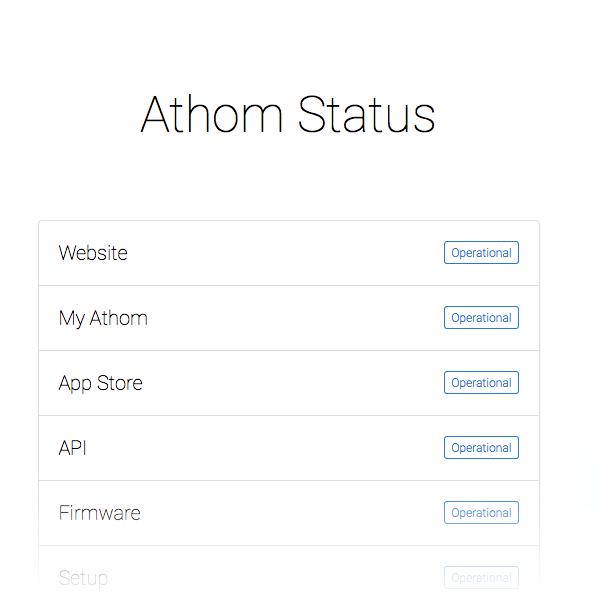

Cloud
We've designed Homey to be mostly independent of Cloud services, because there's nothing more frustrating than not being able to turn your lights on because some 3rd party doesn't feel like it that day. So Homey itself is fully accessible locally, and in the improbable event that Athom goes bankrupt and is forced to shutdown the servers, most Homey functionality will still work. That doesn't mean that our Cloud isn't a work of art in itself though. We maintain various services running to extend Homey. Most of them can also be found on our Athom Status, as well as their health.
My Athom
This is the portal to your Homey(s). It is also the server that your Homey is always connected with, so you can reach it from anywhere in the world. When you're visiting my.athom.com on your local network, it automatically detects this. That way, when you click on your Homey, the browser is redirected to the Homey's LAN address for the quickest interaction. When your Homey can not be reached locally, a proxy URL will be used. This looks like https://your_homey_id.homey.athom.com and is unique for that specific Homey. All traffic that goes to that URL is proxied through My Athom, and from there to your Homey over the persistent connection it has with My Athom. When using this proxy, you can imagine we have to handle a lot of traffic. Luckily we've built the system so that all content such as images, fonts, html etc. is downloaded from our CDN, a Content Delivery Network that has servers across the world. So only the Homey-specific traffic, or 'API calls', are proxied. Not bad, right? This might seem cumbersome, but the alternative would have been to let the user open ports in his or her router, disable firewalls etc. That would be a technical hassle we didn't want our users to have to go through, as it goes against our 'even my mom can use it'-philosophy. (Sorry, mom.)

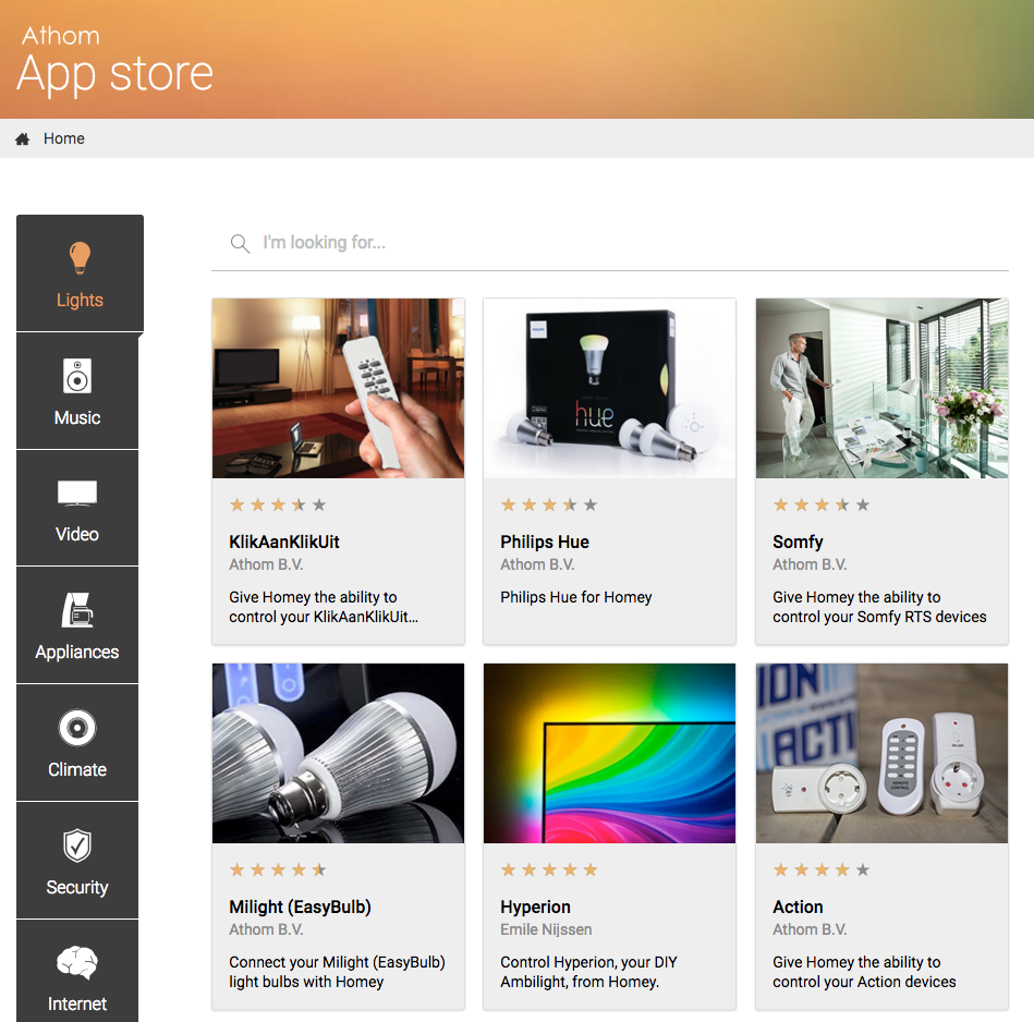

App Store
The App Store is where you go to get new Apps for your Homey. When logged in, you can select which Homey you want to install the app to.
 Developers can submit their Apps here as well, which are then reviewed by someone at Athom to assure the quality is up to par. This review process will get better over time, because we also have to learn what non-Athom developers come up with!
API
This is the service that connects to our database where all Homeys are stored, which user has access to whichs Homeys, etc. In the end, a Homey itself decides if a user may access it. So the API is more of a telephone book than a master key. We can't access a Homey, even if we wanted to, without a Homey owner's permissions.
Setup
The Setup service has been built to connect your Homey to Wi-Fi. When Homey hasn't been set up yet, or Homey is turned upside down, the Wi-Fi Recovery is started on Homey. This is essentially a webserver where the Setup service can send commands to. These commands can be things like 'Which Wi-Fi networks do you see?' or 'Connect to this network with this password'. Additionally, we can execute a shell script on Homey, to fix any bugs we might encounter after a Homey leaves the factory. These scripts are signed and thus can only be made by Athom, which leaves Homey secure, yet updatable.
Speech to Text
This is the service that converts audio into a piece of text of what you said. When Homey has heard 'OK Homey', a connection to this server is opened, and the microphone's recordings are streamed to this server, until a certain amount of silence has been heard. This server then forwards the audio to 3rd party services, and when they come back, we compare them to pick the best result. A few factors are weighted here such as speed, accuracy and 'dynamic-ness'. Some servers are very good at dynamic words such as artists or movie names, but they are generally slower. So when we detect words that hint on dynamic words, such as 'music', 'movie', 'play' etc, the Speech to Text service at least waits for the 3rd party service that's best at detecting those to finish. This way we can ensure the best results for each scenario.
Firmware
The Firmware service is where all Homey's updates are coming from. Homey checks for updates regularly, and the Firmware service returns an update when it's available, depending on your channel (stable or experimental) and current Homey version. Usually the service returns a list of patches to get your Homey from version A to version B. For example, if you're on version 0.8.20, and 0.8.29 is the latest version, and you're in the stable channel, then all patches in the stable channel are returned, for example 0.8.20-to-0.8.27 and 0.8.27-to-0.8.29. These are then installed by Homey in that exact order. This way we guarantee that every Homey has the same software installed. If your version is corrupt, because an update was interrupted yet Homey still magically is able to work (usually a 0.0.0 version), a full image is served. This contains the complete filesystem, and is flashed at once to get your Homey to the latest software. In the future, we will release a tool for Mac and PC that will completely wipe a Homey to its factory state, even if a homey can't be accessed anymore because an update went wrong.
Notifications
This service makes sure that your Homey can send Push notifications to your smartphone. It keeps track of installed smartphone apps, and connects them to a Homey. In the future, more types of Push notifications will be added. For example, we have recently added a 'morse code', so you can vibrate your phone in a pattern from a Flow!
Webhooks
A Homey is usually placed behind a router at home, and is not reachable by external servers. The Webhooks service is made for developers to let their Apps receive notifications from external services. For example, when an App has support for a thermostat, it has two options to detect if the temperature has changed. It can ask every x seconds for a value, calling polling, or wait for the thermostat itself to notify of a change, calling push. Polling is very inefficient and, as you can imagine, creates a delay between changes. The Webhooks service allows external services, such as the thermostat from the example, to notify a Homey directly without caring about firewalls. It just sends a HTTP request to https://webhooks.athom.com/webhook/the_webhook_id, which is then forwarded to the right Homey, which forwards it to the right App, which in return shows the right temperature on your screen.
Callback
This is a very simple service that enables apps to make use of OAuth2 access, which you might know from 'Do you want to give this application access to ...' dialogs. Because these services usually require a static callback URL, but Homey's own URL is dynamic, this service forwards that data to a Homey. That's all!
Other services
There are more services running, such as the website, forum, a service for in our factory, a service for infrared codes, and soon a new support service that will give our support people a way to remotely assist on a Homey!
