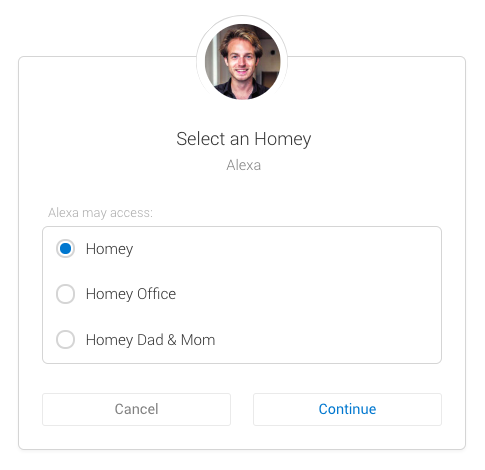

OAuth2 Login
The first one is something you maybe have already noticed. The login screen has changed in that you can now give access to specific Homeys to a 3rd party app. For example, if you had more than one Homey and wanted to use the Amazon Alexa integration, you'd have to say 'Alexa, select a Homey'. That's now changed to a simple radio button during the authentication.
Of course, not many people have more than one Homey so this example isn't really recognisable. What this update does behind the scenes is a lot more interesting. I've talked before about the Web API, and that it opens up new possibilities for Community Developers to create Homey integrations that not only run on Homey, but also somewhere else. Examples are IFTTT, HomeyScript, Google Assistant etc.
We've created the first few building blocks towards a complete open system where you can give delegated access to someone else's cloud integration. It's similar to 'Log-in with Facebook', where you can decide if the app can post to your Timeline, for example.
With this update, we've also got rid of the static keys that Homey v1.x uses. Homey v2.0 uses something called rolling sessions, which increases security even more.
