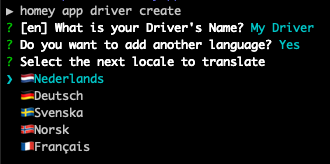

Discovery & Flow Cards
To make Homey app development even easier, the Homey CLI will now guide you through setting up a new Driver (homey app driver create), a Flow Card (homey app flow create), a Discovery Strategy (homey app discovery create). In most cases you won't need to touch those JSON files anymore.
Localization
Localised strings will now be asked for interactively.
You'll always be asked for the English language first, because it's required. Additional languages can then be entered easily.

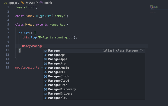

Automatic code completion
All new Homey apps created using homey app create are linked with the homey module on npm. This adds code completion in any supporting IDE.
You can add this functionality to your existing apps by running npm i --save-dev homey.
